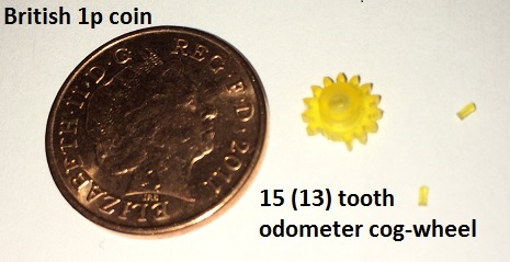

I recently had a problem with my odometer - it froze at 165010. The speedo, however, worked fine. The speedo in my car only has an odometer dial - it does not have a tripmeter dial as this function is part of the OBC display in the tacho.
A little research turned-up odometer fix instructions.
A little more research turned-up Odometer Gears.
Success - after a couple of false starts.
Many thanks to Odometer Gears for their product and their help. I highly recommend having a go at doing this yourself - using a dial repairer would probably cost a few hundred, I would imagine, and a new one from Porsche is about £1000 + VAT.
A quick question - does anyone know if Porsche would clock the odometer with the last recorded mileage? Or would they install it at 000000 and simply stamp the service book with the last recorded mileage? I'm quite proud of the 165k my car's done and want to display this - she looks and performs great.
