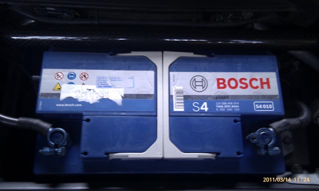

Well guys thanks for all your help with this and for taking the time out to explain some of the facts.
Thought I'd just show you the offending item that the Porsche dealership suggests would burn the alternator out!
Its an 80AH Bosch S4010 battery but perhaps its the wrong colour or doesn't have the word Porsche on it.
Cheers Guys
JJ
There's a Bosch catalogue here http://rb-aa.bosch.com/aa-batterien/gb/media/BA_Pkw_Kleintransporter_Anwendung.pdf identifying which battery fits which car. 986 and 987 listed as 85Ah S5010 or 80Ah S4010.
