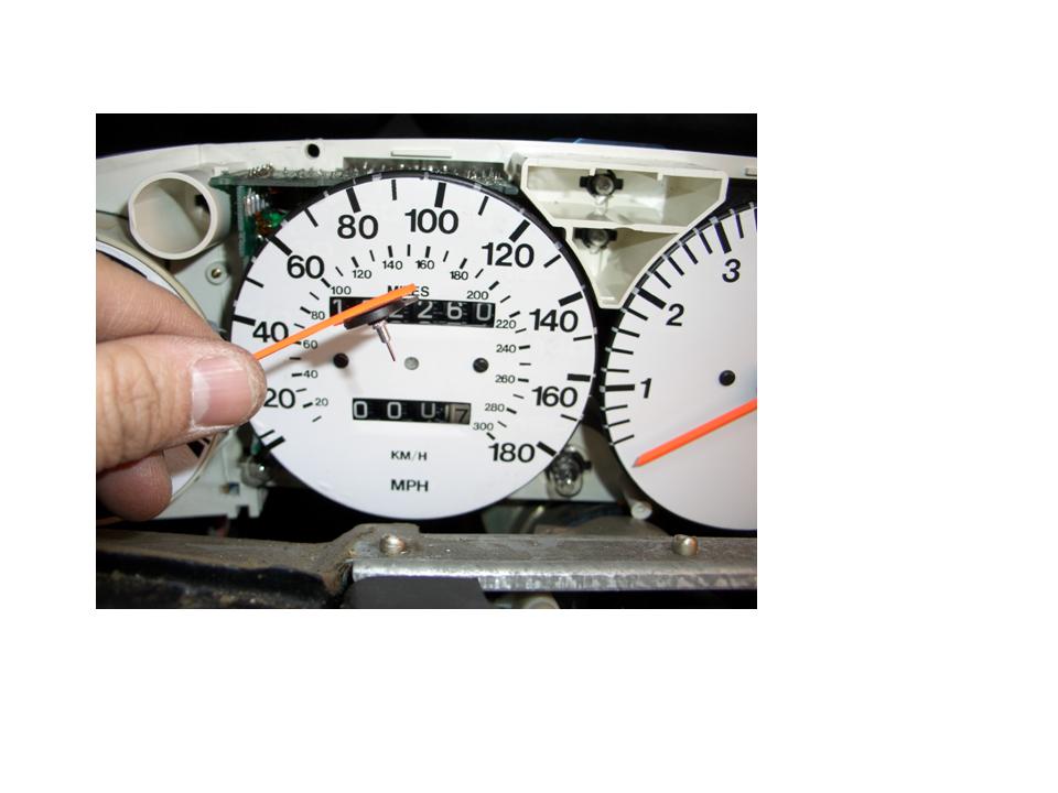

I have taken out the instrument cluster today to put back the temp guage needle and put the new bulbs in. After I have tested they all work and before putting the plaster cover back, my fingers slipped and I have accidentally clipped and broken the speedo needle (see pic)[&:] . What a plonker I am [&o][&o][&o]. I assume a call to a breaker is unavoidable and just wonder how much a used instrument cluster will cost me [&o].

This is the picture of the broken speedo needle

I have actually broken the metal pole where the plastic needle rests on. I try to describe the findings as clearly as I can ...
I have opened the face (and to take out the counter too) to realise that the broken metal pole (very thin steel rod) goes down to the middle of the device where it joins with another bigger moving metal parts via a plastic tube (could be a conector). The rest of the broken metal pole is still left in that plastice tube which is connected to the main moving device. I have a feeling that the broken metal pole is part of the whole moving device which moves as one unit. I think I will lucky just to get that metal rod spares (if its a replacement part) from VDO?

I will give them a call and other breakers a call on Monday to see if there are knackered ones but working speedo. When I took out the speedo face and the counter, I noticed that there some resistors shouldered onto the VDO speedo unit which shouldn't be a big task. Ideally, I just want to replace the speedo unit, my last resort is to replace the whole instrument cluster.

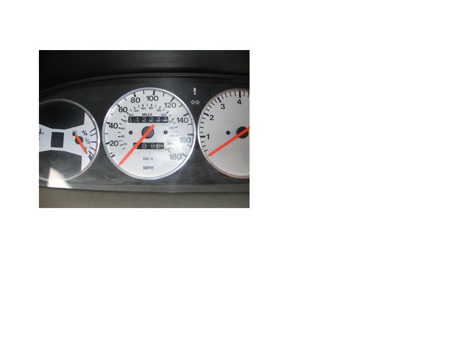

My speedo needle when idle rests well below the lowest mark (see photo) - I may need to adjust it. Is it right? Please advice
Charles
Its all fixed now. The speedo needle is now aligned with 0 mph with the S2 speedo dial (after some careful manipulation this time [:)]) and shows correct mph.
My conclusion is the circuit boards in the S2 speedo module is different from the Lux where the spline (spindle) part is the same on both.
