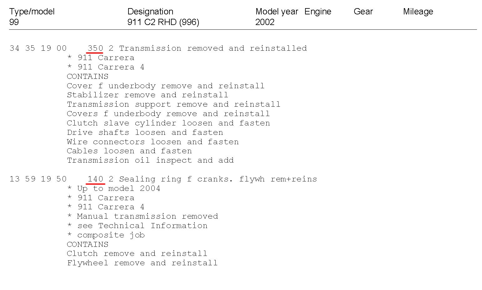

I assume you mean the Rear Main Oil Seal which is a fairly common problem on these cars. You don't say if your car is C2 or C4, but either way it doesn't sound like the OPC is doing you much of a favour. The book time for an RMS is about 5 hours, plus a £10 seal. Find yourself a good independent and save a couple of hundred quid. It makes sense to change the clutch at the same time, as there is no extra labour content. A heavy pedal is a sure sign of a worn clutch.

50% of OPC labour charges should be similar costs to an independent. It sounds like the OPC is quoting more hours than the book job as Richard has mentioned. Suggest to them that you believe the book job to be 5 hours for a RMS change and see where the difference is.

I've attached the book times. 3.5 hous to remove the transmission, plus 1.4 hours to change the seal. I would have thought that an independent would charge around £300-350 to do the same job (add £360 for a genuine Porsche clutch). I would ask the OPC if they would accept a receipt (showing that genuine parts had been used) from an independent specialist as evidence that the work had been completed and allow you to take out the warranty. As for the brakes, it sounds like they don't really know, so it could be a simple matter of damper pads, which are £15.03 +VAT each. Again, I'd get an indy to sort that out too.
