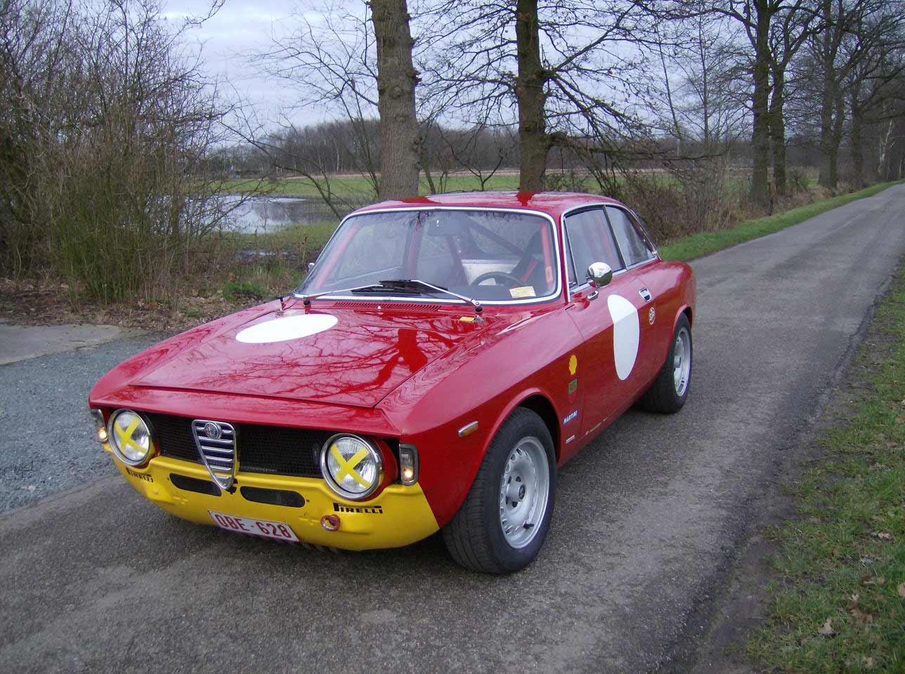

Lack of time to use it mainly. Also, I've nearly finished re-building the alfa guilia gta-rep track car which i think i told you about so that I'll be looking to spend time tracking that. Hopefully I've managed to attach a picture of it...
