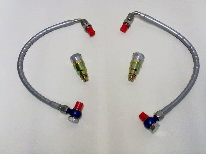

I wanted to get Northway to do the much talked about 996t non-return valve conversion, but they couldn't find who to get the modified lines from - there is precious little room so the valves themselves fit, but need a u-shaped connector on the lines. Any ideas anyone?

You are probably talking about these;
They are available from Powermarques 01724 784897, Nigel is the the man to talk to.
I replaced them on my 993tt earlier this year for the same reasons you mentioned. These cars do get a bit of oil in the induction pipes and intercooler, it`s nothing to get concerned over. I find after mine has been stood a while over the winter months and is not having long regular runs that is when the problem is at it`s worst.

Very useful Dave, I gave Powermarques a call: the valves and lines are £300+VAT. Probably not a DIY (for me at least) so I'll wait until the car needs to go back to Northway for something else.
One thing to watch out for - those valves seal onto the body of the turbo whereas the factory lines are a flare-style fitting within the threaded bore. If your turbos are original the sealing surface may be too corroded to obtain a good seal.
