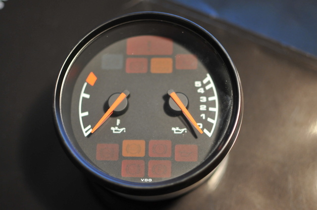

Here is a picture showing the warning lights. I'm going to check solder joints and apply voltage to see if I can diagnose the problem. Will upload pictures of internals later.
Rob,
Thanks for the PM - doh! - I can't believe I made that mistake - I was convinced all my lights were inside the rev-counter and the speedo - but it's almost the opposite - the lights are mostly in the minor instruments - just like yours. I was so convinced I had to go out and look in the car - just the same as yours. Sorry for any confusion - in future I'll look at the car and not trust memory.[8|]

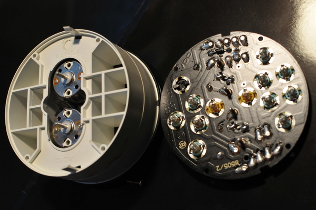

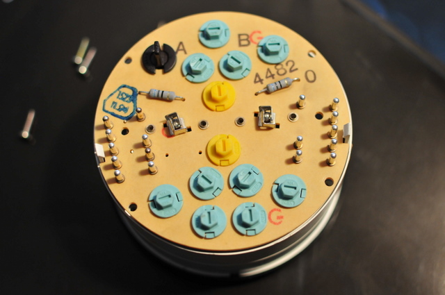

Mark,[FONT=verdana,geneva"] [FONT=verdana,geneva"]No problem, and thanks for your interest. I thought I would try to diagnose the problem myself before sending it off for repair. So I have re-soldered all the connections and will test it in the car, (but I don't expect it will help as the solder joints were all good). I also checked the resistance of the two windings in the gauge. From reading up about how these air-core meters work, I'd expect them to be the same resistance, but they aren't (anybody out there know more about this ?). I need to look into this some more, but it's looking like the problem is inside the gauge and I'll have to buy a second hand gauge or send mine off for repair.[FONT=verdana,geneva"] [FONT=verdana,geneva"]Rob[FONT=verdana,geneva"]
Rather to my surprise it looks like simply re-soldering the connections has fixed the problem [:D]. I only went for a short test drive and won't be 100% convinced until I've done a 100+ mile journey. I'll keep you posted !
Rob
Not surprised - 964s were notorious for this - dodgy solder on dash instruments. I spent years re-soldering mine on my 1989 C4. I thought Porsche has fixed this with the 993 Doh - appears I was wrong.....
Just to confirm: oil pressure gauge operation is now completely normal after re-making all the solder joints. Checking this has provided an ideal excuse for some extended testing runs in my local Cotswold lanes over the last few weeks [:D]
