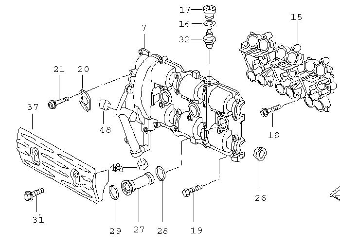

Can someone please tell me the location of the oil pressure sender on a 2002 C4s?
Is it hard to change and get to?
As you look at the engine from the rear, it's on the right hand side, on the top of the cylinder head, towards the back of the engine compartment (pointing vertically upwards). Item 32 in the picture. Not too difficult to get at.
