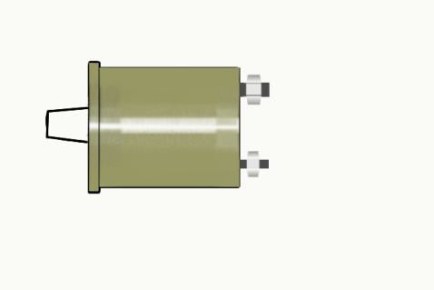

Should look like this roughly, as I just drew it in Corel photo paint
You may have part number 021 919 081B, which is listed on pet as a sender but I don't know what in the world it is used for. Any Porsche 924 2.0 I have worked on has has had part 047 919 561; that's a 1978 N/asp, 1981 (Tu), 1982 (Tu), and a 1983 N/asp. 047 919 561 actually has a 4mm stud and a five mm stud for the electrtical connections.
