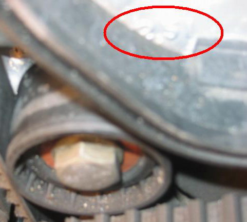

The marking can be seen from the pump even when it's mounted on the car (except if it's a turbo, of course [8D]).
It is on the upper part of the pump, just above the upper ending part of the belts plastic casing.
Can't come up with a better picture than this one, sorry ...
Bit late in the reply, but I have just gotten Apollo 13 back (woo hoo) from being lavished with cash and the serial number from the old pump is 944.106 124.R1.

Does the "new type" water pumper has a "2.5" marking on it or a "2.7"
The replacement pump has 2.5 on it.
