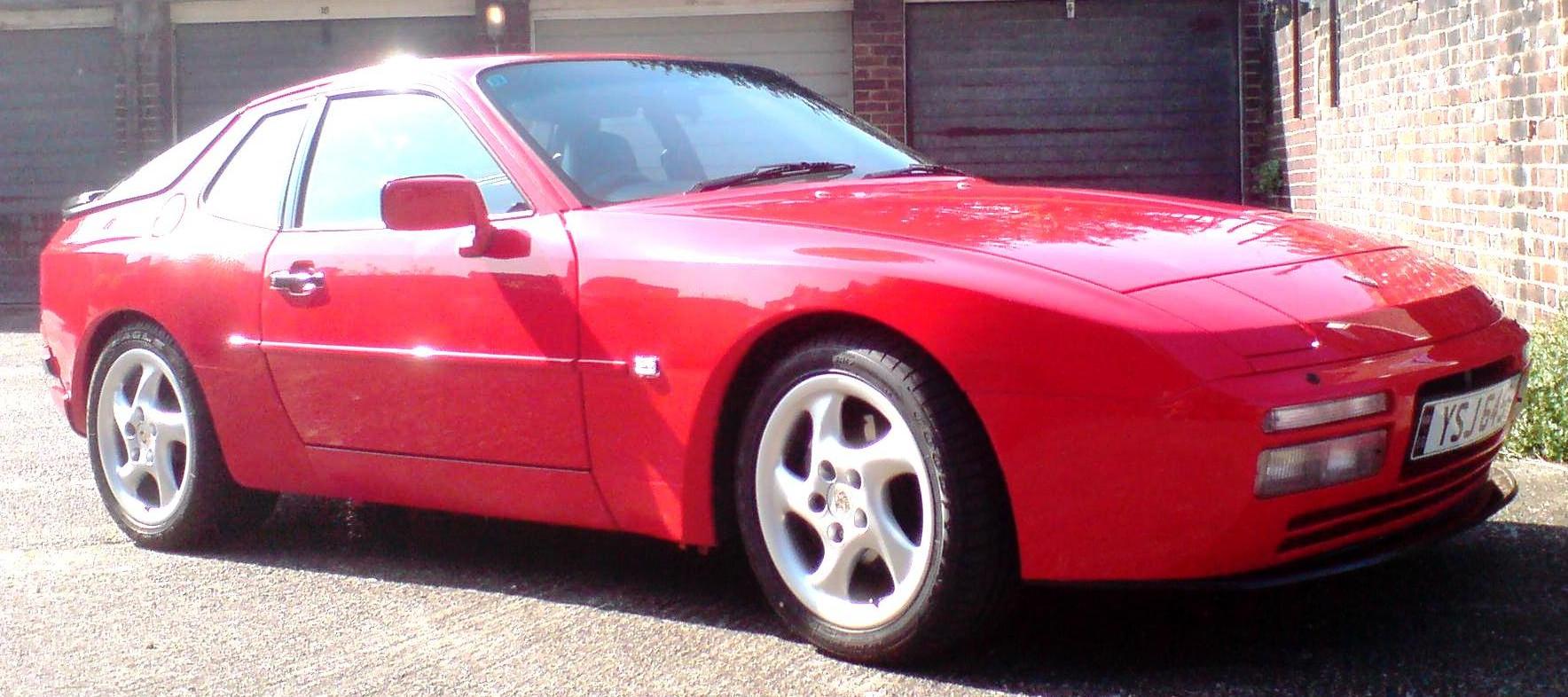

But in its place is a newer, faster version.
90 G 952.
I've had this a couple of months now and have requested a few bits of info so far.
Good bits - well bought for a good price and even with immediate post buy spending it only owes me decent 944T money. This includes all new brakes and belts, a few bits bit of brake pipe, ARBs,thermostats and a waist down respray and rust removal and proofing. Ok so the bonnet and roof could do with some attention to be the same colour!
And the clock works!
It is basically a 1 owner car - ok the real first owner kept it for 9 months and then px at Sytners Nottingham for something BMW/Alpina I suppose but owner 2 kept it 17 years. So I have all the paperwork for this - and there is lots. Last bill was a total top end rebuild totalling 4K!!
Splashed out on a CS wheel and some CS alloys but as these came with decent Conti sports it wasn't a bad buy at all.
Fixed a few interior bits - broken vents, gear lever gaitor etc.
Bad bits - well the car hasn't been used much for 18 months so I am still ironing out a few bits.
I have an annoying electrical fault in the temp gauge which means every 2 or 3 days I will be sailing along and the gauge will jump up to 100+ and then come down to 85 again. I've had the dash out, cleaned up all the earth points I can find and changed the stats but to no avail. I have cleaned the sender contacts as they looked a bit green but this is the next bit to be changed.
Turbo dash gauge only ever reaches 1.2 but an external gauge has shown 1.7 but I still don't think the cycling valve is operating as it should.
I imagine a new fuel pump wouldn't hurt as I get the hot start problem too.
Oh and the speedo reads 212K but you wouldn't know it!
Still nothing that stops me using it and when I've fixed everything that falls off it will be off to Mr S at Promax for a little extra help.
And its red so it obviously goes faster!
Looks nice. Definitely the right colour. On your boost issues then 1.7bar (absolute) is about right for a stock turbo and pressure control system. Sure the manual say's 0.8bar max pressure, but with a 17yr old wastegate you can easily loose a bar of pressure there due to it opening prematurely. A DPW will sort that out no probs!

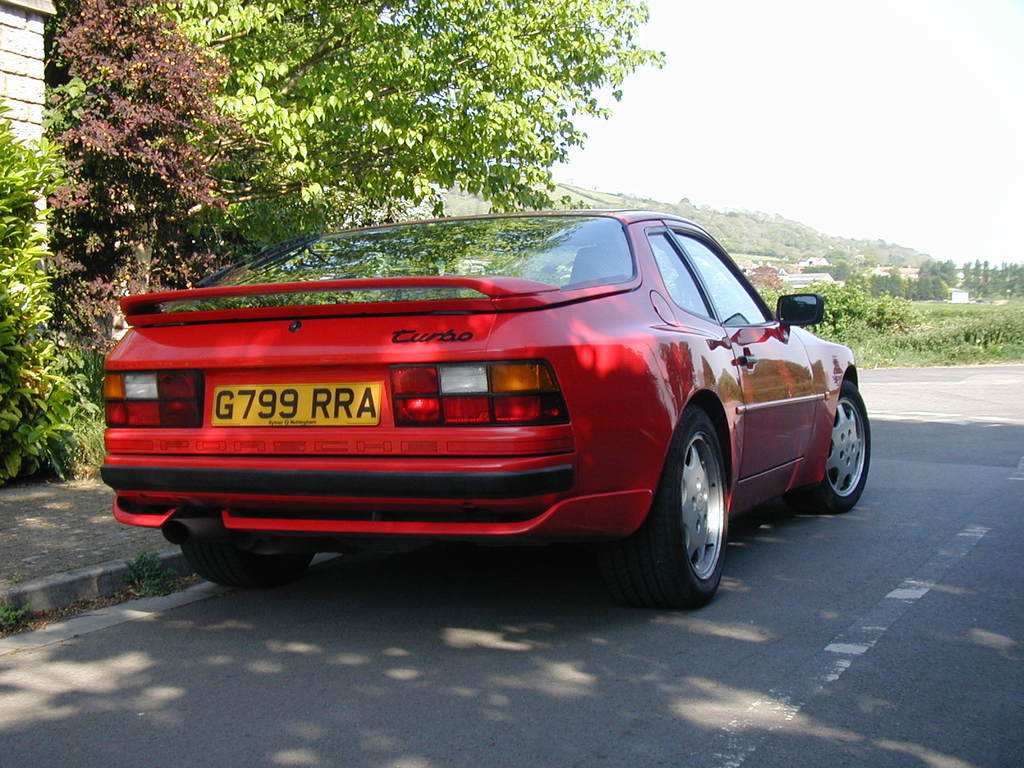

Looks good. I would have kept the standard D90s. (better check my rear number plate position)

The wheels we're on the car when i bought it..... they've grown on me actually, give the car a fresher more modern look especially when combined with the clear indicators and front splitter which i fitted.
