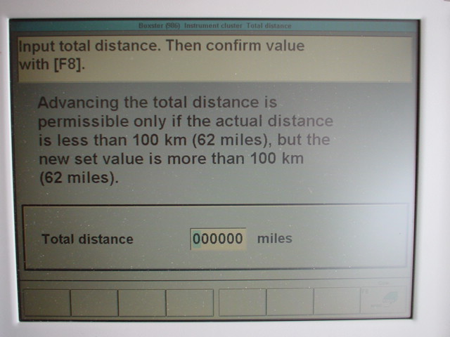

I chatted with the tech guy for some time and he showed me how the test unit would not sync my milage into the silver cluster unit. He could not manually write the old milage in.
If it was a new cluster then the info is placed in and this process I was told can only be done once. So if I bought a new unit from Porsche, I would have the invoice, my true milage goes in and all is well. No dispute if someone was to question any cluster change.

Oh, dear. As per my email last Saturday, it isn't possible to adjust the mileage with a PST2 when fitting a used cluster. It can only be done on a brand new, unused, cluster.

Once a cluster has 62 or more miles on it it is locked and a PST2/PIWIS cannot change it. But aftermarket companies can.

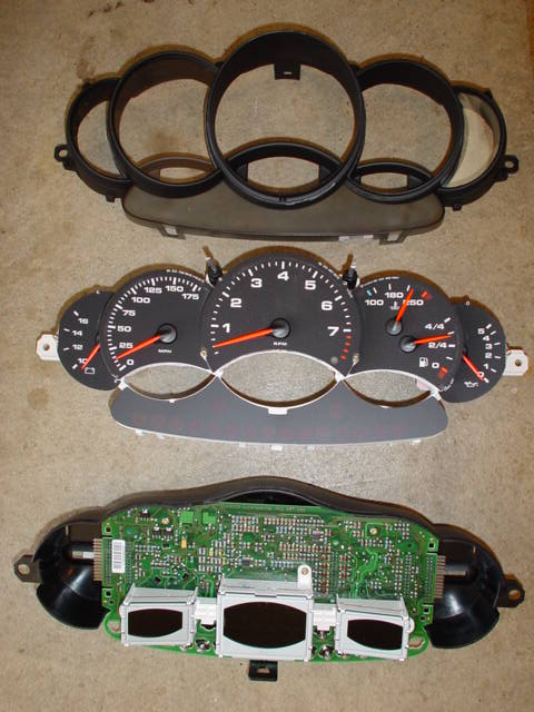

Probably a silly question but would it be possible to remove the electronics from the exisiting cluster shell and fit into the new cluster shell with the silver dials?

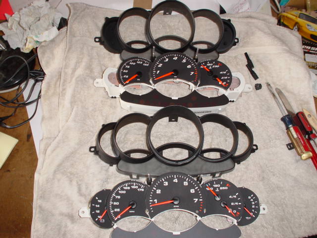

You take both clusters apart and swap the dial assembly. That way the silver dials will be in your original cluster. It is not hard to take a cluster apart if you are handy. If not then ask a speedometer shop to do it.
The other way, as I said, is to have the mileage changed in the "new" cluster to match your original cluster. As I said, an OPC cannot do this with their equipment. Aftermarket companies can change the mileage. A speedometer shop that deals with electronic clusters may have the equipment to do it.
