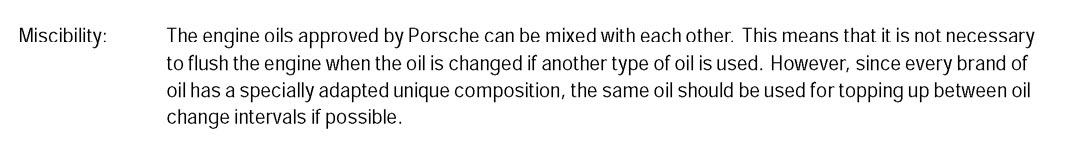

I doubt if it would be detrimental to top up with an oil of equivalent specification. This is what it says in the Approved Oils TSB - note the last two words...
I was trying to find an article I read about never mixing multi-grade oil, but couldn't find it ... I found this one, but its not as detailed as the one I read previously. I think, the essence of the issue is that the particular chemicals one manufacturer puts in their oil is not necessarily compatible with that of other manufacturers. Personally I would never mix oils, but maybe i'm being too idealistic.
