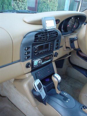

This is where I put mine. Not terribly elegant, but practical. I wired it (and the phone) into the radio feed, as it stays on until the key is removed from the ignition. I found that the cigar lighter went off with the ignition.
