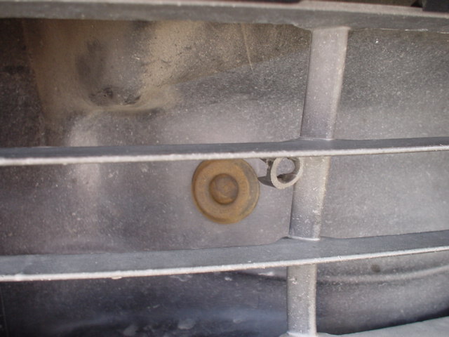

I can tell you what I have seen and what I have been told. At least for an early 986 US car.
Aircon has always been standard in the US. The very early 986s did not have the sensor unless the car had the OBC option. These were model year 1997 (the first year for the Boxster) that were built in 1996 for model year 1997.
We have 2 local model year 1997 owners and their cars were built in November and December 1996 without the OBC option. Both have aircon because that is standard in the US, but neither have the outside air temp sensor in the front grill. My model year 1997 was made in January 1997. I have aircon because that is standard, but I also have the sensor even though I do not have the OBC option. So I have always assumed that a US car made prior to January 1997 did not have the sensor unless the car had the OBC option. All US cars I have seen made in January 1997 and after had the sensor even if the car did not have the OBC option.
About 5 years ago the December 1996 owner wanted to have the outside temp display turned on. When a mechanic I know turned it on all you saw in the instrument cluster was 3 dashes, - - -, because this car did not have the sensor. The mechanic told me we needed to install the sensor. So we installed the sensor and wired it to the instrument cluster, and then he could see the temp display.
The mechanic said he was told by Porsche to install the sensor on the very cars because the aircon system was not working properly without the sensor, or something like that.
I asked the mechanic who turned the display on why this car did not have the sensor, but mine did, as they were otherwise identical cars built a month apart. Again, it had something to do with the aircon.
I would have to look at the wiring diagrams to see if the sensor has anything to do with the aircon. Until then I am just repeating what I was told.
This is a picture of the November 1996 car.
