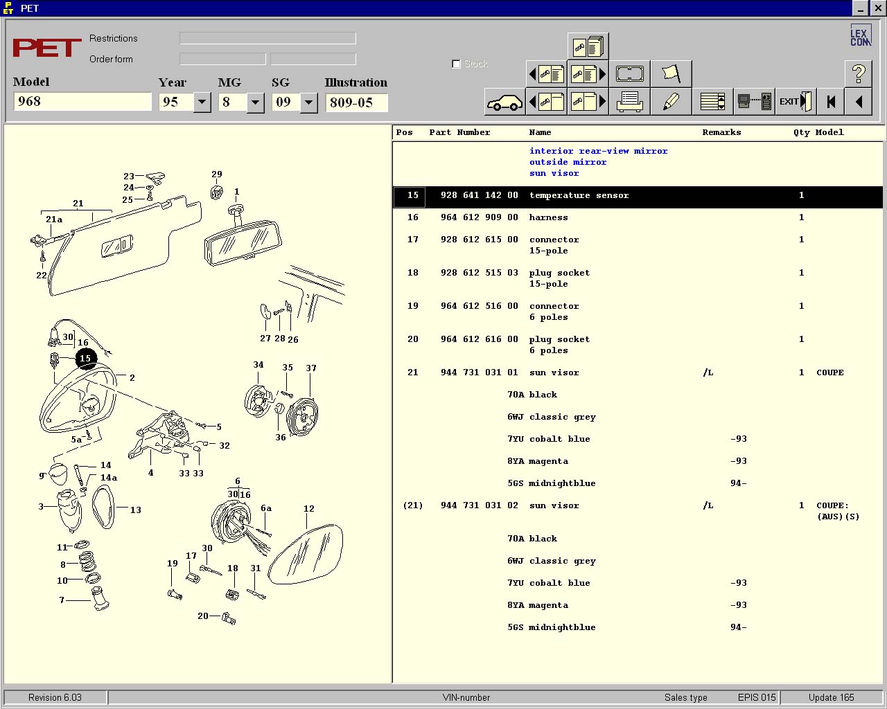

I have been offered the outside temperature guage from a 968 that is being broken to replace my non working time clock in the S2 Cab as long as I remove what I need myself. Getting the display unit out of the dash is easy enough but where is the sensor located, pictures and/or good descriptions on a post card to .........................
Graeme,
It's in the near side (LH) mirror. See attached diagram.
Dave
It's located in the nearside (RHD) mirror housing. If you need a sensor there is one on ebay.
