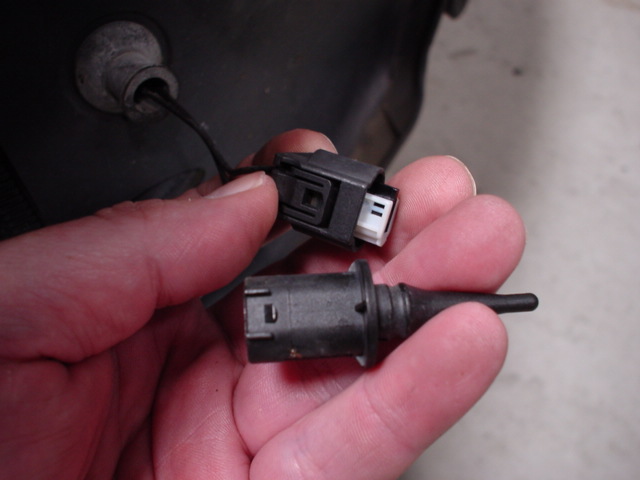

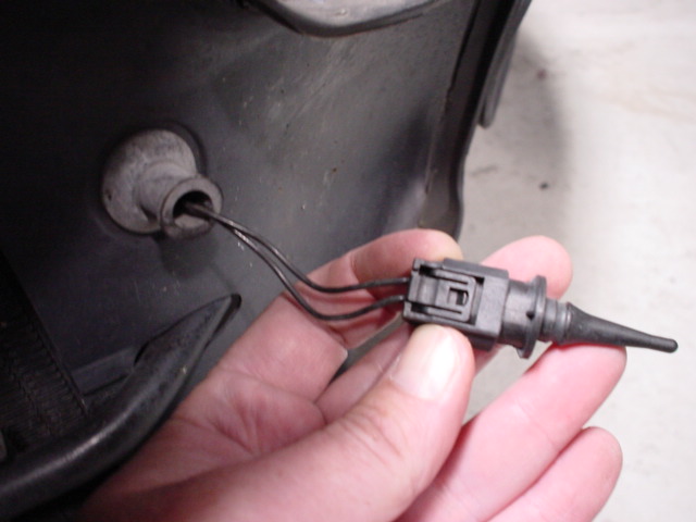

Would like to see a picture of what you have.
If there are just 2 wires and no male connector on the end then someone or something cut it off. When the male and female connectors are connected they are not going to come apart via vibration since there are supposed to be locked together via 2 locking tabs.
Not clever enough to upload a photo, but looking at your photos the rubber grommet (if that's the right term) that the wires come through the body work through is missing, with just the two bare wires hanging through.
Not obvious in your photos is that there is a ring behind the horizontal spar on the air intake that I assume the sensor slots into.
I wonder whether I did dislodge it a few days ago washing the car, and that it was bumping hard enough around to get pulled off the wires. There is no sign of any connectors.
