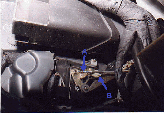

Sounds like your little white plastic clip is broken.
At the left of the heater unit is an actuator arm which moves the mixing vanes. The arm is connected by a little white plastic clip, which breaks. You might be able to feel it, or see it, up between the heater and glove box; or take out your glove box liner.

I would check the white plastic clip is not broken.
Remove glove box and see if it looks like this broken one.
Rod (A) should be held by clip (B)

That is indeed the one - Just to confirm, the picture shows a broken clip, not what it should look like. [;)]

It does sound like you do have a heater flap problem though
