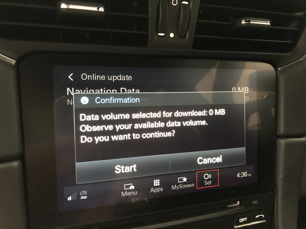

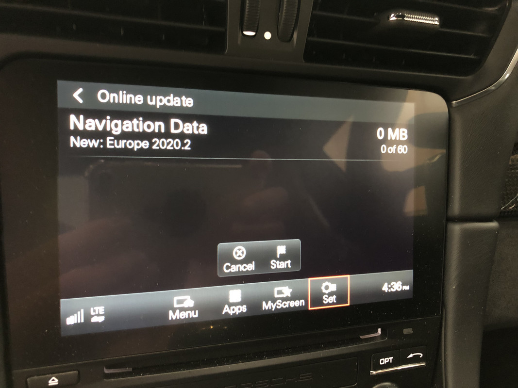

I have raised the issue perhaps duplicating others' contacts with Porsche Connect. If it is not available I'd like a refund. Anyway after 5 days they have come back to me with "can I send screen shots" so I sent these of how it looks on my PCM.
First screen does not offer much comfort..
Next one suggests I confirm my low expectations
Then confirmation..
Is this what others see?

Looking at the first of your screenshots further back in the thread, have you tried selecting that top line which says "0 of 60" you should then get a list of all the region updates available but you will only be able to select 3 regions?
ralphmusic said:
I’m sure that’s what I did. Appointment with Porsche Centre put back to early December.
But in the sequence of screen shots it looks like you selected 0MB then tried too start the download. If you had selected up to 3 regions the amount of data would have shown where it shows 0MB, depending on which regions you selected it would have been anywhere from 200MB to 1.5GB.
Just to respond again, I went through the same routine and whether I select 1, 2 or 3 regions the result is the same, no update.
