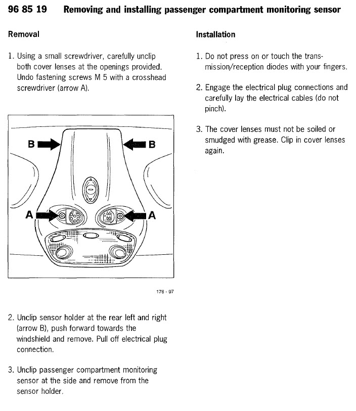

Hi I have just had my sunroof switch disappear into the plastic molding. I guess that either the tabs on the plastic surround or the switch have broken? Can some one please advise me how I can take the plastic surround down to see if I can repair it?
Many thanks! Michael.
Here you go:
Richard
Many thanks for the attachment. I found the tab on the plastic molding was broken so will need to replace it but have made a temporary repair for now. At least the switch operates and stays where it is.
