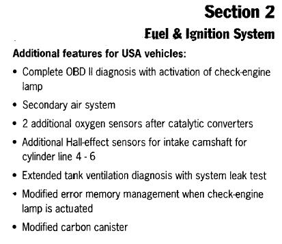

Are you saying that PET is wrong? It clearly shows and lists 4 sensors ...........
When I spoke to Lloyd you really seemed to know what he was talking about he said tree are just 2 precat sensors on my model an he was very confident about that.
The RoW (inc UK) 2.5 Boxsters and early 996's use Bosch Motronic DME 5.2.2, which is not OBD2 compliant. They only have pre-cat O2 sensors. US cars ARE OBD2 compliant, which have O2 sensors after the cat. These two after-cat sensors monitor the efficiency of the catalytic converters, and have no effect on fuelling. For the 2.7 Boxsters, and 996's with electronic trrottle, they introduced Motronic 7.2, which is OBD2 compliant, and hence has 4 sensors.
