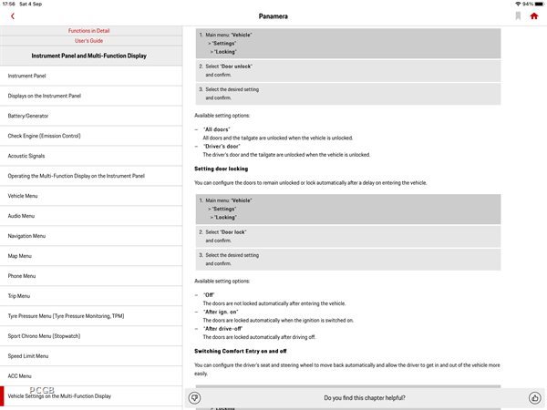

Just a thought before you get into the details of the mechanism - worth checking that something hasn’t gone awry with the locking set up in the menus as it can be set to unlock drivers door only which may give the symptoms you describe. I’ve tried to attach the relevant page from "good to know" but if it’s failed I’m sure the manual can point you in the right direction regards which menus.
That said I have no idea of a good reason for why it may have changed !
Thanks Stephen,
Appreciate the attachments - very helpful - I’ll look at the menu selections in the morning when I take The car out. I’ll also have a look at my book as well this evening to make sure I know the right menu option.

Hi Stephen,
Unfortunately no. I read the lock section in the manual, checked the menu in the car settings and it was already set to 'open all doors'.
I deselected it, re selected it and it didn't make any difference.
