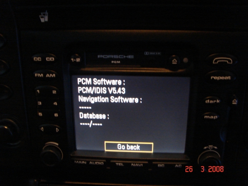

i have just bought a 2002 996 Carrera 4 with PCM1 16 bit version, everything works except the sat nav part, i get a cd read error every time i try to switch to it, i have pressed the button on the A/C screen to see which version of the operating system i have but it has nothing stored, it just has _ _ _ _ _ on display under the writing ( where i would assume it should have PONA628D or something similar)

hi, tried both of those, even had it apart to clean the lens, put it back together and still get this
where abouts are you? I have PCM with original discs which works fine (surprising how few road changes there have been in the last 6 years). I am in the North West and would be happy to let you try using my discs - at least then you'd know if it was a hardware or software problem.
