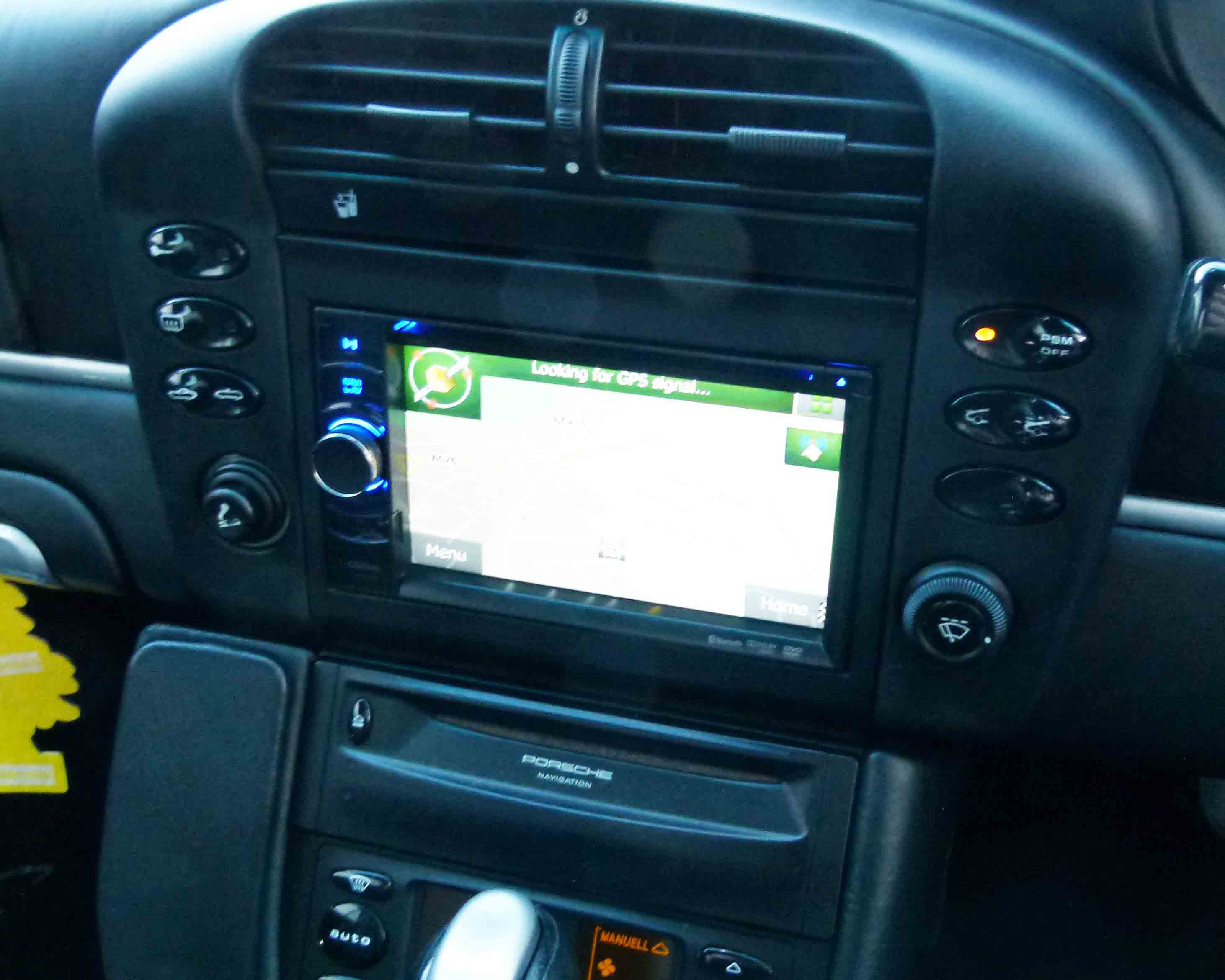

Well done Dave. I would suggest getting one of these wiring kits: http://www.carstereos4u.co.uk/product/1731-1613/Porsche-911-Car-ISO-Lead-for-Fully-Amplified-System You might not need all the bits, but it will make sure you have what you need before you start. I think you should also be able to get one from Halfords. (Autoleads PC9-410).
You'll probably need a surround trim, as the PCM opening in the dash is about 10mm taller than Double-DIN. I haven't seen them sold separately, but here is the complete facia and cage kit: http://www.carstereos4u.co.uk/product/6607-2206/CT23PO02Porsche911DoubleDinFaciaPanelAdaptorCageKit

Finally installed today.
Looks good but need to tidy th wiring up and remove the old satnav player when the weather comes a little warmer.
Picture quality isnt up to much.
Dave
