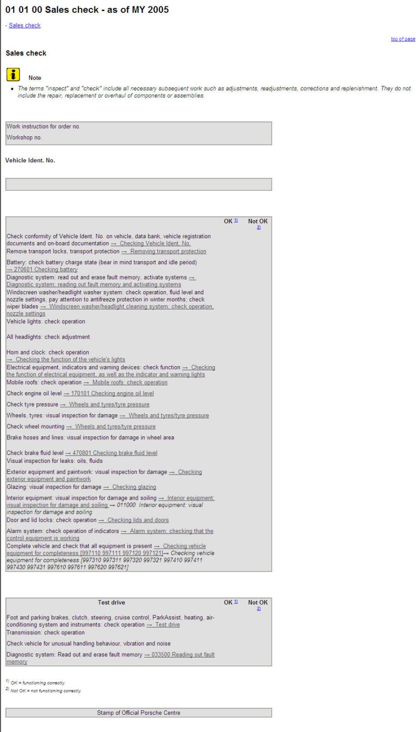

Three months later and I am still waiting for my Pre Delivery Inspection (PDI) printout I was promised.
Anyway, does anyone know what the split for responsibility on checks is between the Factory and the OPC? Things like wheel alignment, who should be checking that?
Does anyone have a list of what is actually checked in a PDI and at the OPC?
Many thanks [:)]
OK - apparently the Wheel Alignments are checked by the factory prior to shipping.
You then have 1000 miles warranty on the alignment before it will then cost you £270 to have it checked again.
So anyone picking up a new car, I suggest you try have your geometrey retested as early as possible as I have heard of a lot of Porsche owners with their settings from the factory being out.
As I have done over 2000 miles in my car now, I have asked my OPC for the official 997 Turbo alignment specs and I will get my local garage to check them for less than 1/3 of that price!
