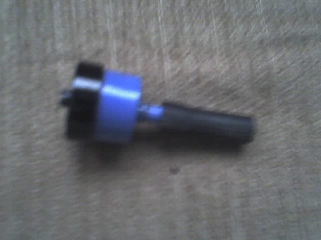

there is a little valve under the bonnet near the bulkhead under the inlet manifold make sure it has not come disconnected from the pipe if it has it will blow hot all the time HERE IS A PICTURE OF THE VALVE-
