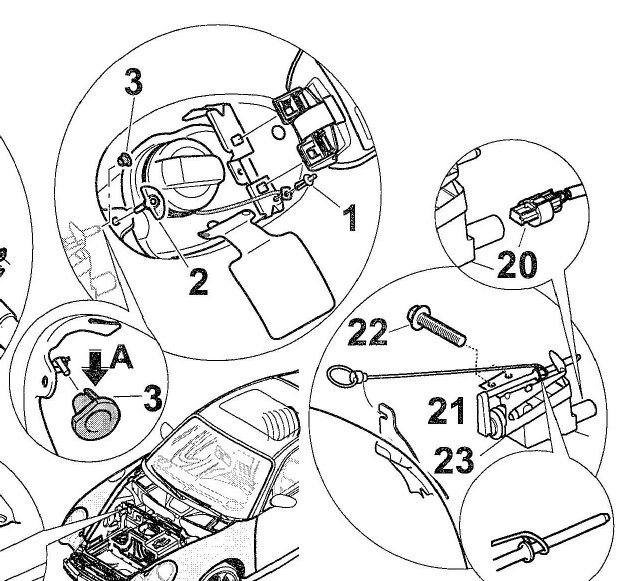

It is usually item no 3 in the photo. It hasn't happened to mine (yet) but I think the bush normally falls out and gets lost. The acuator pin then gets stuck the wrong side of the panel and won't come through the hole. There was a thread on here or the Boxster forum some while ago which might be worth searching for. (I'll leave that to you as I can't get much sense out of the search facility).
