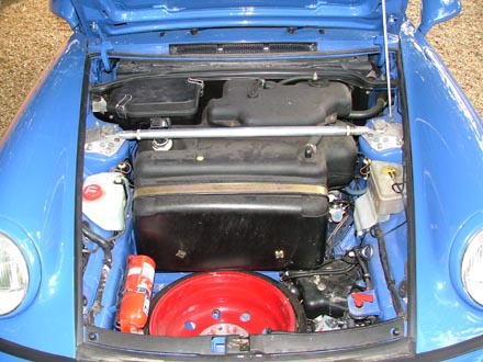

The tank, whether big or small, has no impact on the fitting of the strut brace (the only difference with the big tank is that it encroaches into the area immediately behind and above the space saver).
RHDs had the smaller tank as standard but you could "special" order the larger tank.
Damen

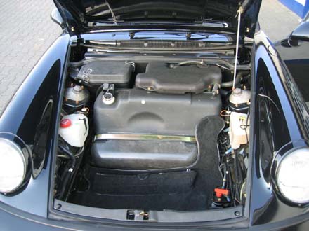

Are you sure? See below, picture of a large tank in a lhd car (and a small/standard tank in my rhd car, attached to my next post).
Damen
