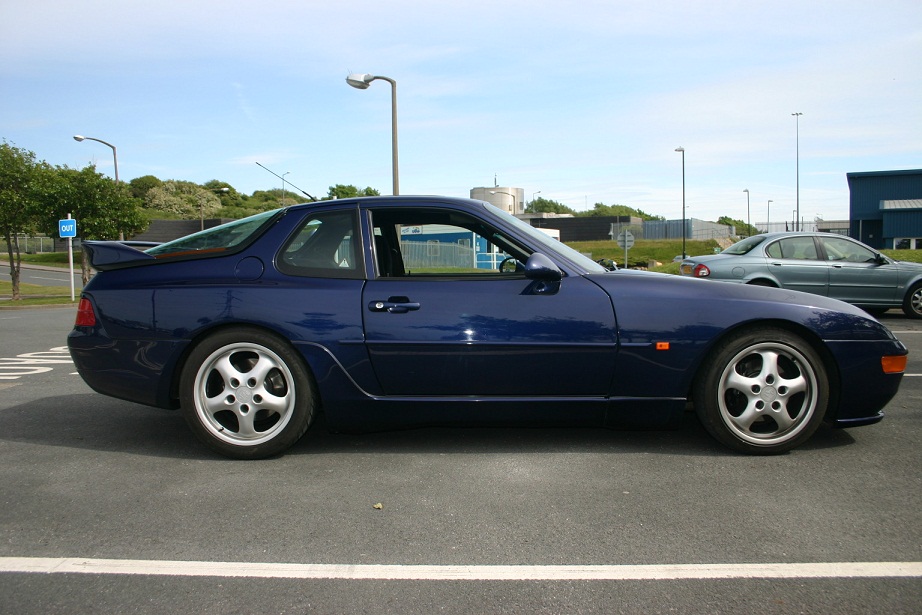

This is mine....

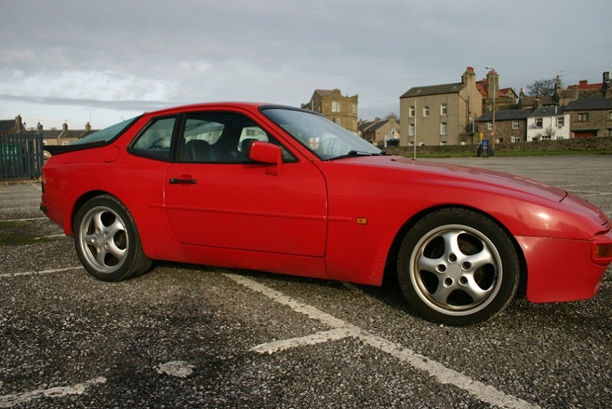

..and this is a really low S2 on 16's that RPM had in for a while. It looked soooo good this low but I think they had to chop the jacking points on the sills back a little[:D]

Great picture of the old girl Rav ! [:)]
Thanks John - she's still going strong.
Mike - well spotted - are you a Policeman ? [:D] I didn't even notice that it was open.
