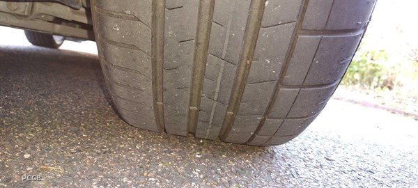

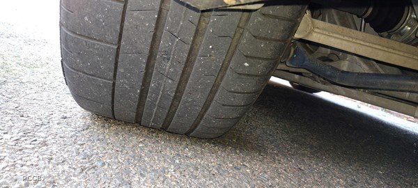

The offside rear tyre is less worn than the nearside. I understand that this due to the tyre being replaced due to suffering a non-repairable puncture. (See image).
The offside rear tyre has a very thin grooved tread on the outside shoulder of the tyre. There do not appear to be any wear bars in this groove. This groove is entirely absent from the outside shoulder of the nearside tyre. Possibly worn away?
Now comes the numpty question. Is the nearside tyre legal?
The reason I ask is that the legal requirement is the tread has to have a minimum of 1.6 mm depth across the central 75% part of the tyre. If my calculations are correct the central 75% starts and ends 33 mm from the sides of the tyre.
If that is indeed the case, it suggests that the tyre is illegal as the thin grooved tread on the outside shoulder of the tyre is entirely absent.
BTW. Before I purchased the car I asked the OPC for the tread data used as part of the 111 point check and they only provided it for the 4 other grooves for all the tyres.

Hi Alan,
Welcome to the club. Let me say straight away that I am not a tyre expert so this is a layman’s response, however I would certainly say that your tyres are legal. I remember how shocked I was the first time I took the (Pirelli) rears off my car. The absence of "tread” on the outer made me wonder what was going on.
Remember that there are different rubbers in different parts of the tyre. The outer area is like a slick to give maximum lateral grip on a road going tyre. I’m going to stop now and hope some knowledgeable person will give you a more technical response! (How much do you know about tyres, Jeff?).
Gordon.
Ha,ha! Not a lot more than you Gordon … other than that they’re black and round and - along with the brakes - are the most important component on car!??
My own experience is also similar to yours, and would agree that Alan’s tyres are legal since tread depth generally is measured on grooves where the tread bars are located.
Addressing your original post Alan, I’d recommend that you get a full geometry check to ensure that the suspension is within Porsche's specified tolerances.
Jeff
If you bought from OPC, legal requirement is irrelevant as Porsche mandate N rated tyres less than 5 years old with 3mm of tread.
Would be good to see a copy of mandate as certainly both our cars went through OPC checks with tyres older than 5 years. I even pointed out the crazing and was advised not an issue.
