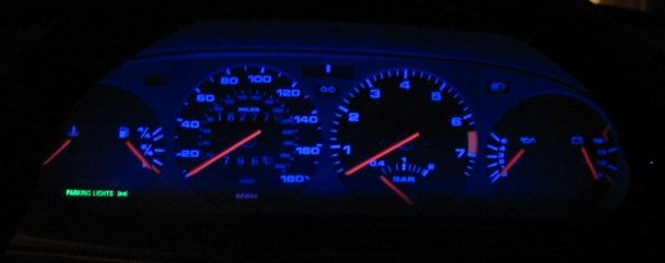

Instruments - 3 bulbs with reflectors that degrade and can make them work badly. Search for posts by Flamingeye on here for a kit to improve things

Just got my Flaming eye kit today in Ocean Blue so now I shall be able to see the dash.
Good turn around from Darren as I only ordered it on Wednesday.
I'm realy pleased with mine, I'm sure you wont be disapointed.
