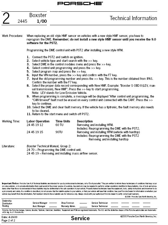

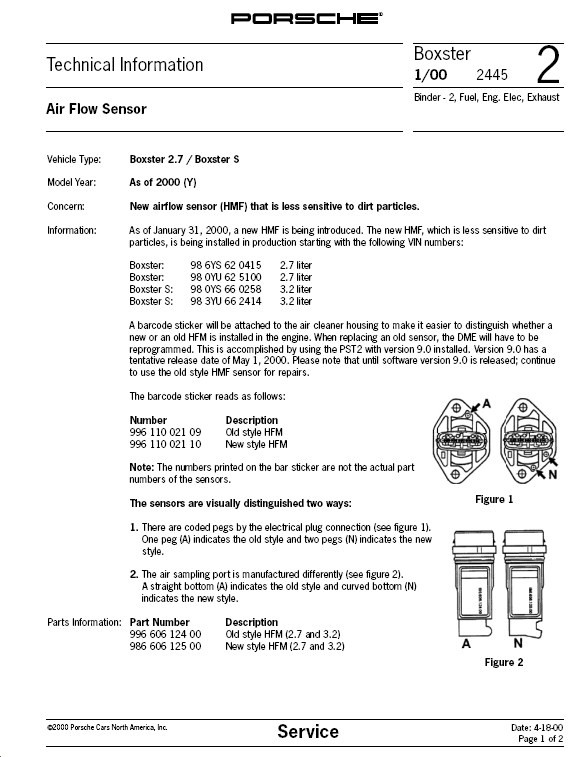

It's interesting that you've found that the MAF has been changed. I would check if you have the right one if I were you because the early 2.7s had a 996 part number MAF and the later ones have a 986 part number. Which one you need will be dependent on your chassis number. HOWEVER a 2.7 initially delivered with a 996 MAF can have a 986 MAF fitted IF the DME is reprogrammed by Porsche (there is an official Porsche tech document on this).
The change of MAFs happened during the 2000 model year. Details of the MAF numbers are:
996 606 124 00 - is for the early 2.7/3.2 cars with chassis numbers up to WPOZZZ98YS602145 (or 42000 which I think are 3.2 numbers).
986 606 125 00 - the latest version. (there is an even slightly later version with 01 at the end but it makes no difference).
If the problem is with your MAF, I see there are two potential scenarios:
1. Your car needs the 996 version and someone has put the later 986 version in but not had the DME re-programmed.
2. Your car had the DME reprogrammed early on but someone has put the old 996 version in as a replacement (this won't work properly with a re-programmed DME).
How do I know all this? Well...I bought a new MAF from my local Porsche centre (£380) who insisted my car should have the 996 part even though the one I took out had 986 on it. The car performed well under par for the following months and I finally got fed up and borrowed a 986 part and hey presto the car got its performance back! It was a very expensive lesson because I couldn't get my money back because the MAF I bought was not faulty (it's just that they supplied the wrong one!).

Here is the USA version of the Tech Bulletin (the Europe one is similar but substitute EU coding in lieu of LEV for a UK Spec car. Hopefully readable:
