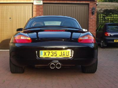

i've solved the Boxsters hairdresser hum by fitting a janspeed exhaust. now it sounds great
