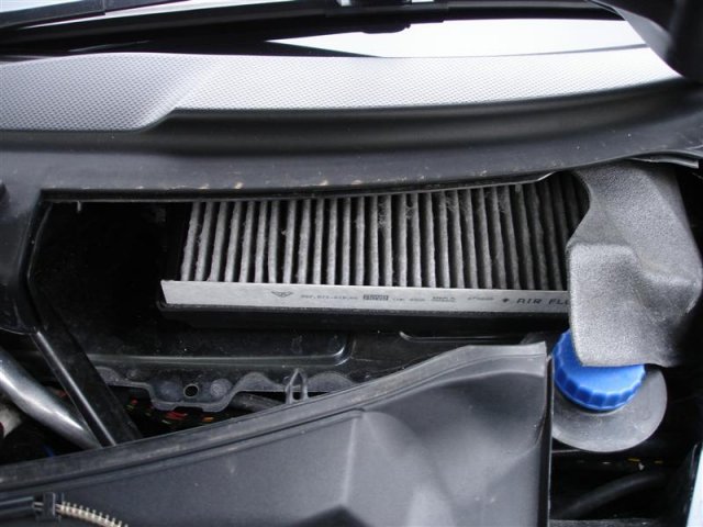

Welcome Dave!
Here's a picture of the filter from our DIY pages:
You can't quite see the clip on the left, but it just catches the top of the filter.
As for aircon leaks, the most common cause is rotted out condensers, where the debris gathers, and occasionally from damaged pipes when the car hasn't been jacked up correctly.

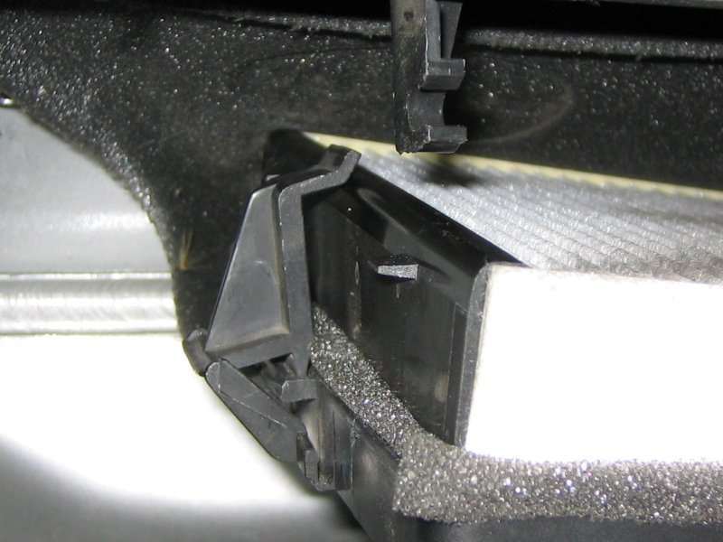

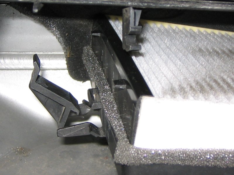

Hi Richard,
Sorry for the delay getting a picture.
This is a pic of the pollen filter and the clip.
As you can see, the clip doesn't hold the filter in place - not sure if something is missing or bent?
Any ideas?
I'm currently holding it down with masking tape

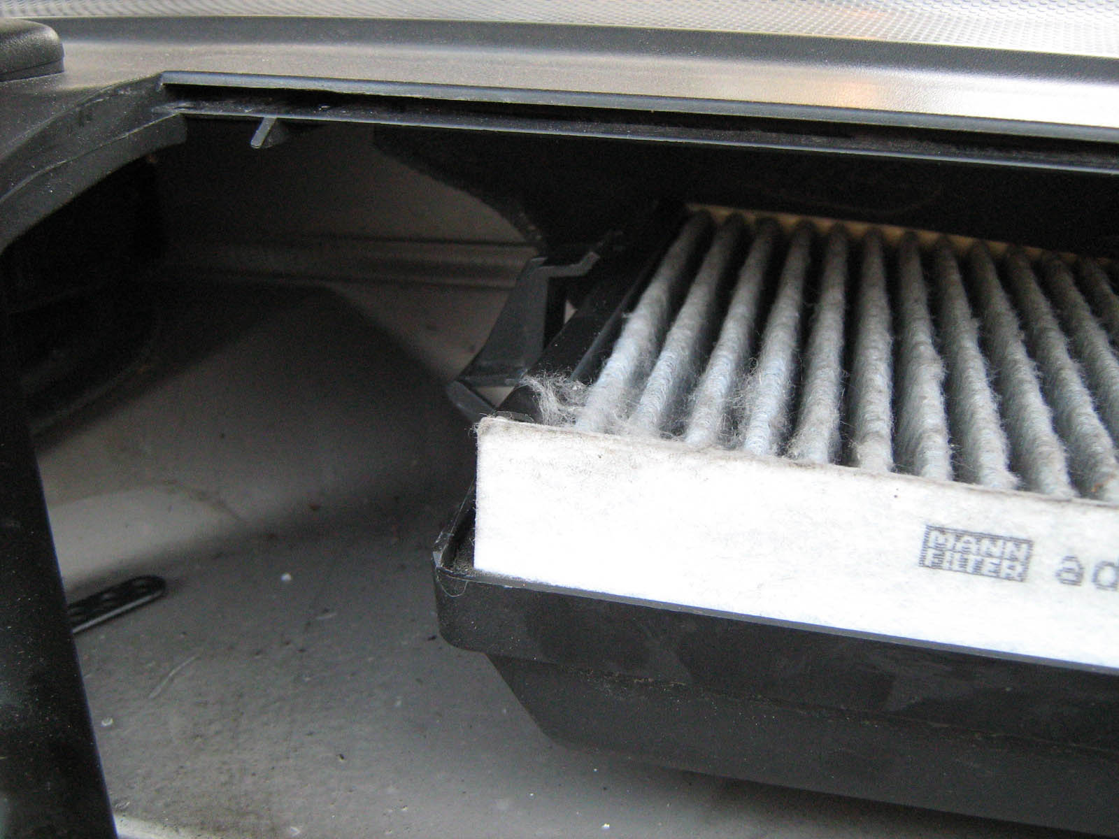

Thanks Richard.
Doesn't seen right that something designed and engineered by the Germans doesn't actually have a purpose.
If that,s the way it is, great - at least it is something that doesn't need replacing.
And with the clip closed. Well, kinda. It just about holds it on mine, but like you say, it isn't very good. Mine is an aftermarket filter though, so that might explain it.
Hi Richard,
Thanks very much for taking the time to post pics.
I guess mine is aftermarket as well, as you say, that may answer the question as to more quite doingthe job.
At least I know that mine is no different that oters out there.
Thanks again, I'll go and find something else to worry about now. [:)]
