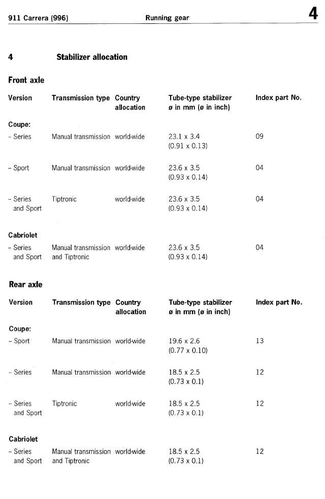

This is going to confuse things even more for you Richard. I looked at the MY1998 Technical Information book, and this is what it says are the diameters of the tubular anti-roll bars for the C2:
Standard (M029):
F - ø23.1 x 3.4
R - ø18.5 x 2.5
Sport (M030):
F - ø23.6 x 3.5
R - ø19.6 x 2.6
I think you need to bite the bullet and measure them at the bush diameter.
A bit more info from the manual, but not much more help:
