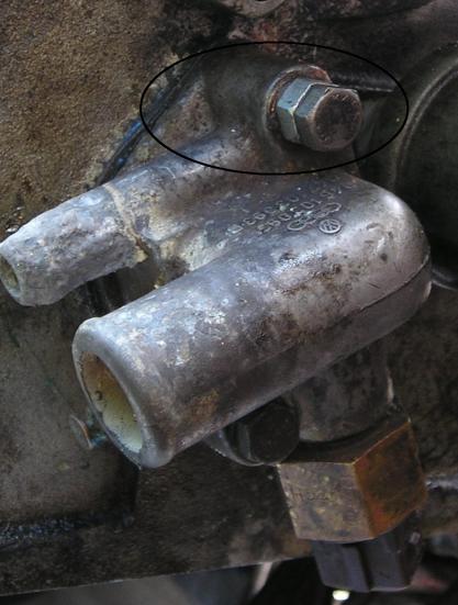

O.K. Firstly Terry is right in that the 5th injector is controlled by the 'sensor at the back of the engine' which is called the thermo-time switch and it earths the cold start injector if the coolant is cold. It is not impossible to get to it but it is blasted awkward. If you want to check it out, drain and collect the coolant, and at the back of the head disconnect the two coolant hoses from the stubs in the picture, and then unbolt the casting, ease it out and disconnect the wires.
