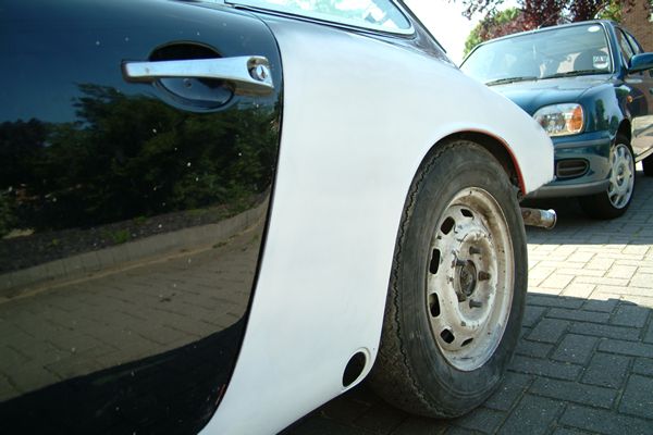

Hello all,
Here's my new project, its a 1968 911S which seems to have been restored as a LWB 911 at some point in its life. Its been for sale down at Nick Moss's place for a little while but I popped down there a few weeks back and we worked out a deal. Whilst the car was down there I got Nick to alter the rear wings back to SWB and fit a new tank support panel as well as buying a few panels which will give me a bit of a head start on the resto. Anyway it got delivered at the weekend, now mid resto its looking a little worse for wear, LWB suspension under primered SWB rear fenders, no front wings and no bumpers. So the wife as you can expect wasnt too impressed with my new purchase!
Its currently fitted with a late 70's interior which I'm in the process of stripping and eventually replacing with an original 68 interior which Ive managed to piece together.
All being well Ive got hold of a pair of SWB front wings today so I'm quite chuffed, I'm eventually going to put her in for a full respray back to her original Metalic Silver.
I'll post some more pics soon as she progresses.
Making fast progress at the moment which is good, Ive been very lucky with parts, having a rusty 68 912 donor has helped a great deal.
if thats the car in the pic its got a fantastic shine to it
