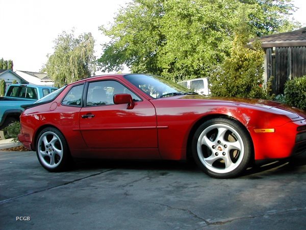

I've just purchased a 944 S2 cabriolet & I wanted to get the 996/993 twist/turbo 18" alloys. It seams to be a minefield of spacing & offset numbers on the internet. Does anyone know the part numbers of the wheels that would fit? Photo for reference is attached.

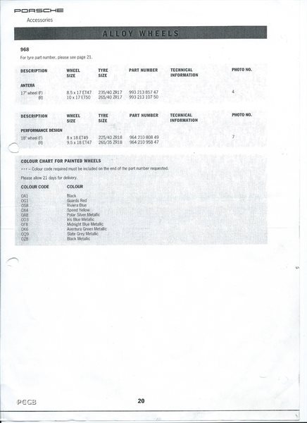

Got a picture of that page for the 18” wheels option on a 968 somewhere
I came across this when I fitted the Techart Performance wheels on my 968. Not much in the way of info but it's all I could find at the time. Has anybody on here got the Porsche Accessories Catalouge from 1992/93/94?
I am selling these wheels, if you havent found a set. They fitted nicely and suit the car well IMO
