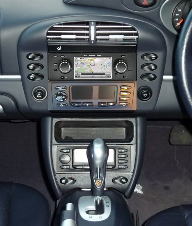

MOST is the fibre optic loop which transmits signals between head unit, amplifier, CD changer, etc.
The only issue you would have in your car is if there was an amplifier. If it has an amp, there are no speaker connections at the head unit end. This means that you would have to bypass the amp, and wire directly to the speaker connections at the amplifier end (in the boot).
If there is no amplifier, then the speakers connect direct to the head unit, which would make the Classic Radio almost plug-and-play. The only additional connection you would need is an ignition-switched supply, as the standard head unit doesn't have one.
Edit: A complete lash-up, but I suppose it wouldn't look too bad....

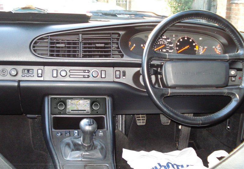

Richard,
Would you be able to make a " look a like for me " of this unit fitted to a 944 as I am thinking about purchasing one?
Many thanks
Richard, thanks for that mate that was kind of you, as you are totally rubbish at this kind of thing would you mind trying again for me?[:D][:D]
well done richard, I think thats a quality lash up! [:D]
