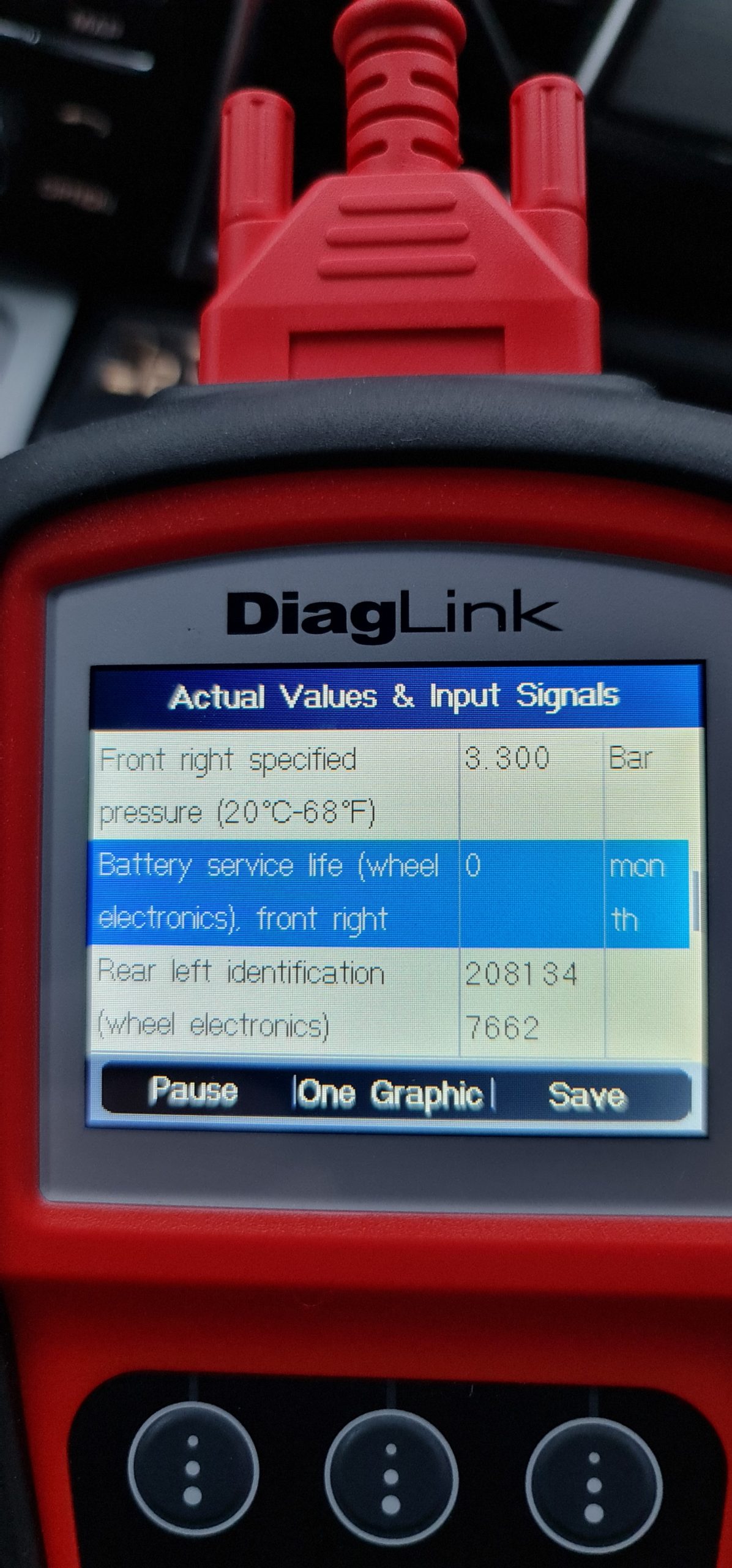

I have the AUTEL DIAG LINK so I checked myself:-

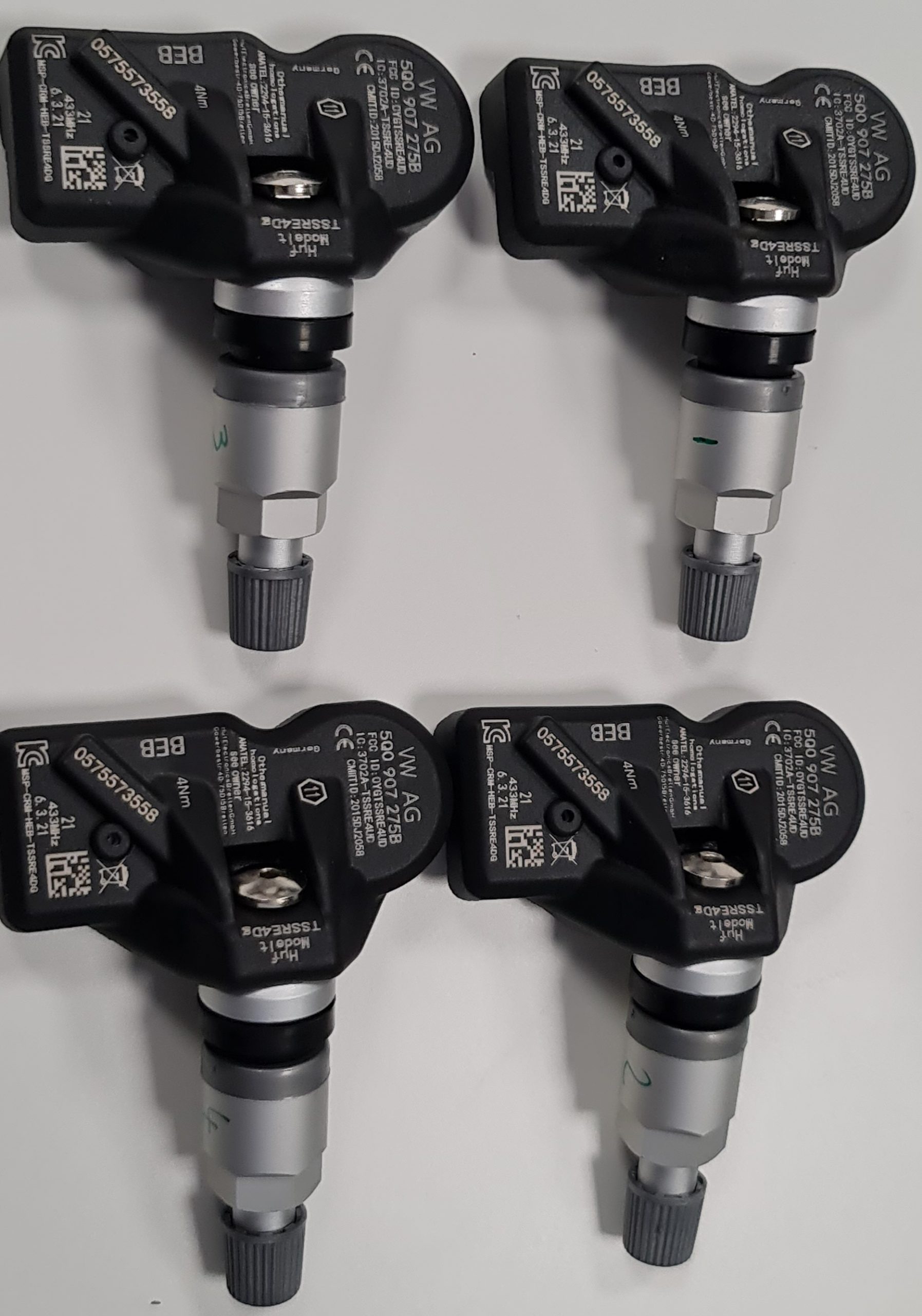

Google shopping found these:-
The numbers:-
VW
5Q0 907 275B
0575573558
433 MHZ
These were advertised as genuine replacement units! As I have not got the original at this point in time I have to trust!

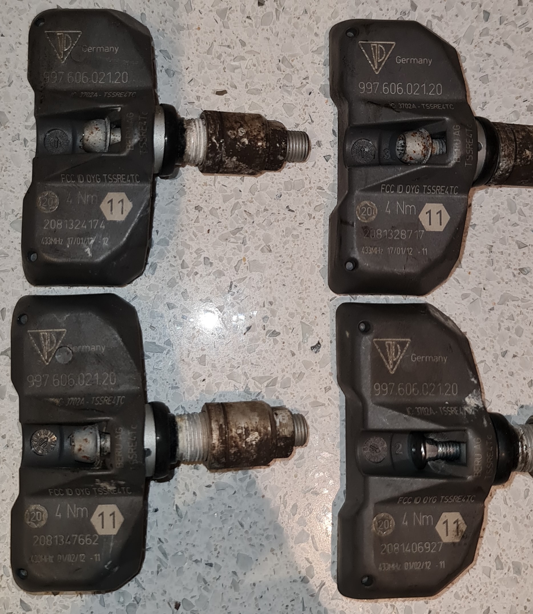

The original units on the car:-
The numbers:-
997.606.021.120
2081347662
433 MHZ

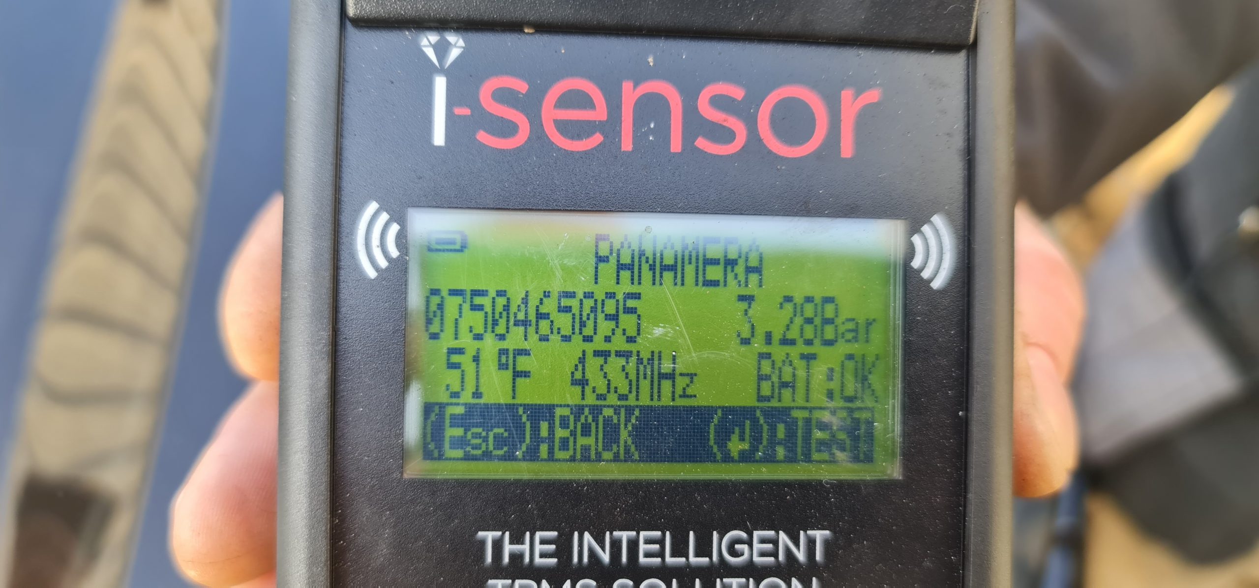

The tyre garage has a TPMS sensor reader / checker:-
All 4 wheels read perfect and each TPMS sensor numbers were noted down.
![Autel-Reading-TPMS-Sensors-6-scaled.jpg](https://www.ianbevis.co.uk/wp-content/uploads/2022/02/Autel-Reading-TPMS-Sensors-6-scaled.jpg)
![Porsche-Panamera-Faulty-TPMS-Sensors-scaled.jpg](https://www.ianbevis.co.uk/wp-content/uploads/2022/02/Porsche-Panamera-Faulty-TPMS-Sensors-scaled.jpg)
The numbers:-
VW
5Q0 907 275B
0575573558
433 MHZ
![Porsche-Panamera-TPMS-Sensors.jpg](https://www.ianbevis.co.uk/wp-content/uploads/2022/02/Porsche-Panamera-TPMS-Sensors.jpg)
The numbers:-
997.606.021.120
2081347662
433 MHZ
![Porsche-Panamera-TPMS-Sensor-Reading-scaled.jpg](https://www.ianbevis.co.uk/wp-content/uploads/2022/02/Porsche-Panamera-TPMS-Sensor-Reading-scaled.jpg)
