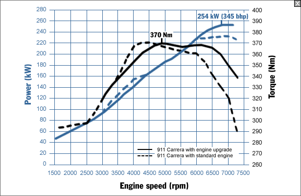

Looking at the power and torque graphs for the conversion, (http://content3.eu.porsche.com/prod/911/carrera4s.nsf/gbrenglish/engineperformance_enhancement) there is a loss of low-end torque and all the gain is at much higher rpm. Not sure it would be of real benefit for road use.

any views on the Torque figures from this 25bhp upgrade ???
as the bhp may not be soo much but it's really all about the Torque !
Well, strictly in the interests of research, I've spent some time in my car today having a play. I don't have a direct comparison with the standard version but what I do notice is that the 911 keeps charging right into the rev limiter. With my F355, the push fades away as you approach the 8500 rpm rev limit and you need to change up to keep the adrenalin flowing. With the 911, because the torque curve is biased towards the higher rev ranges, it is remarkably easy to power right into the rev limit. It feels like the engine will rev for ever and as such, I do like the power upgrade because I wonder whether the normal version would be the same. At the same time, the exhaust note from the (standard) pipes is simply glorious. Add to that the tractability of the C4, the slight but reassuring under-steer and you have a peerless car for cross-country. It's even an accomplished motorway cruiser, just a bit lumpy around town. I love this car!
