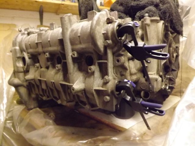

I got to the point of disassembly where I couldn't turn the crankshaft (without forcing it) to even closely align the notches.
So I improvised - a couple of small clamps, remove all the chain tensioners, and remove the camshaft cover VERY carefully. At £650 a throw for camshafts they aren't cheap.
It worked a treat...
