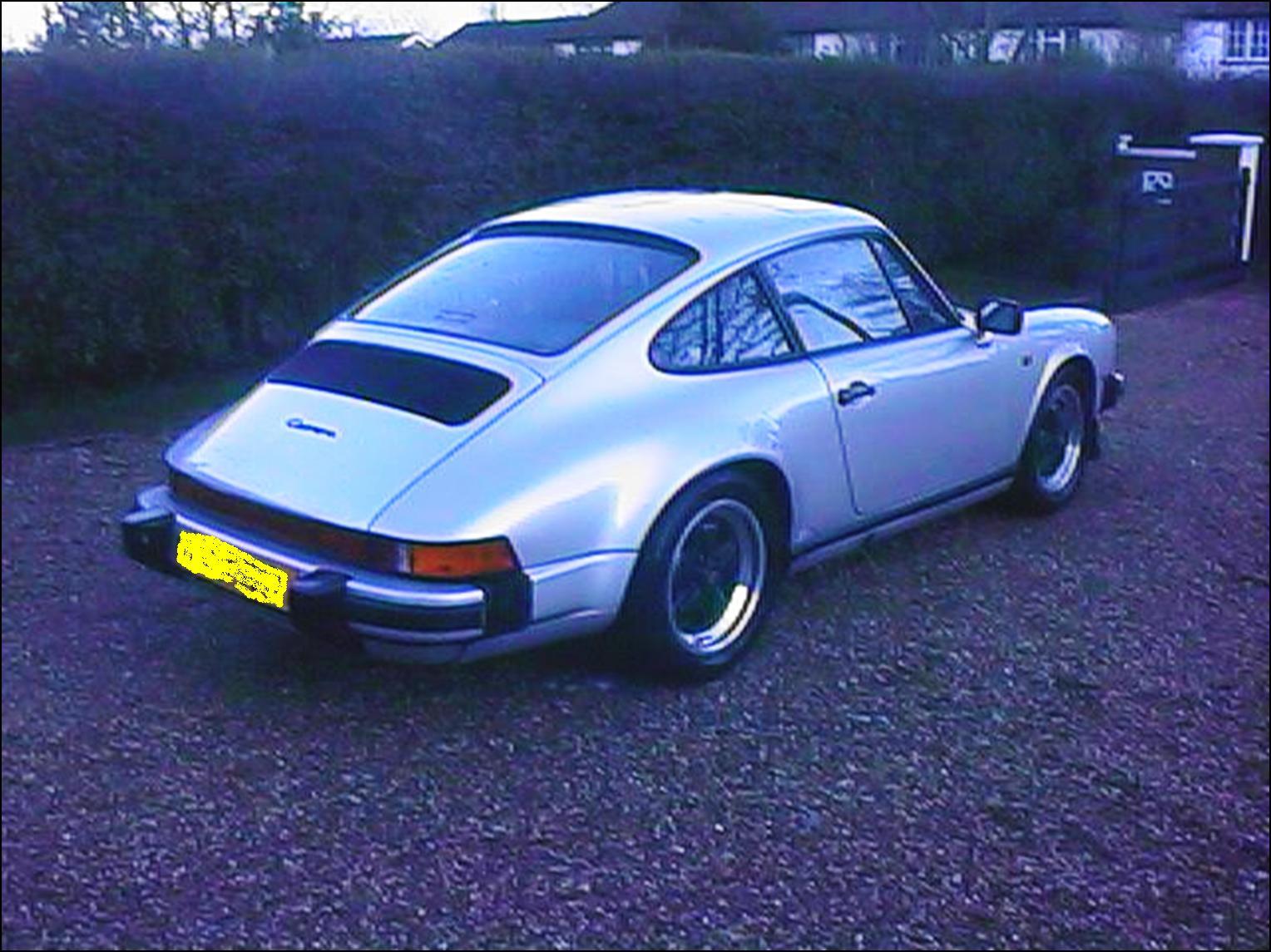

This thread started as pics of my previous 3.2, from which I removed the rear spoiler and replaced with a flat lid.
It's turned into a discussion on spoiler removal, so I've renamed "Porsche truth or myth? No1 Spoiler Removal"

NO rear spoiler is the FUTURE!! Classic clean look is the way forward. My 89 F LHD 3.2 Carrera has no rear spoiler (came from the factory like that) but has the front lip. I have never experienced any handling problems whatsoever. Personally, I think it looks much better without the rear spoiler...nice....
