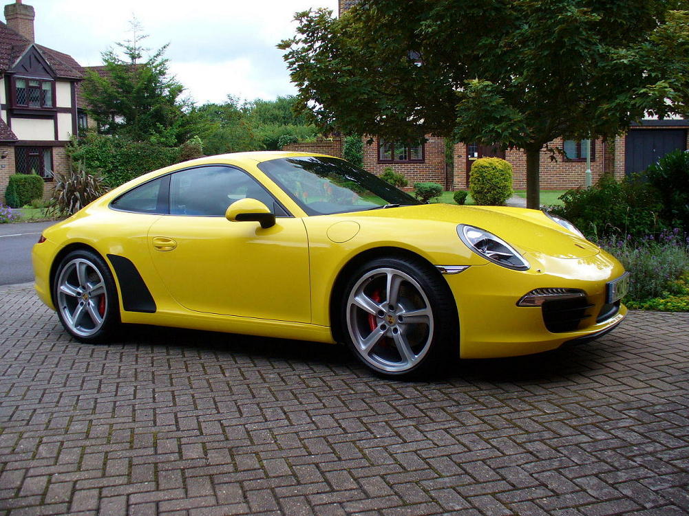

Welcome to the forum and ownership of your new car (pics please!) first one in yellow I've heard of on here. The VTS problem is not one I've come across and yet to receive that particular recall notice yet... I've not had a problem with the VTS thus far, but had no end of issues with the same system on my last Cayenne. When you say the stop/start is intermittent, as you probably know it doesn't always cut out if the battery calls for more charge. Sometimes the engine cuts back in for the same reason. As far as aircon noise goes, does yours have sports exhaust? If so, switch it on and give it a rev, that'll fix it[:D]

I have included a photo below (I hope). The front end is PaintShield wrapped and the picture was taken after John Drake had worked his Zymol magic
