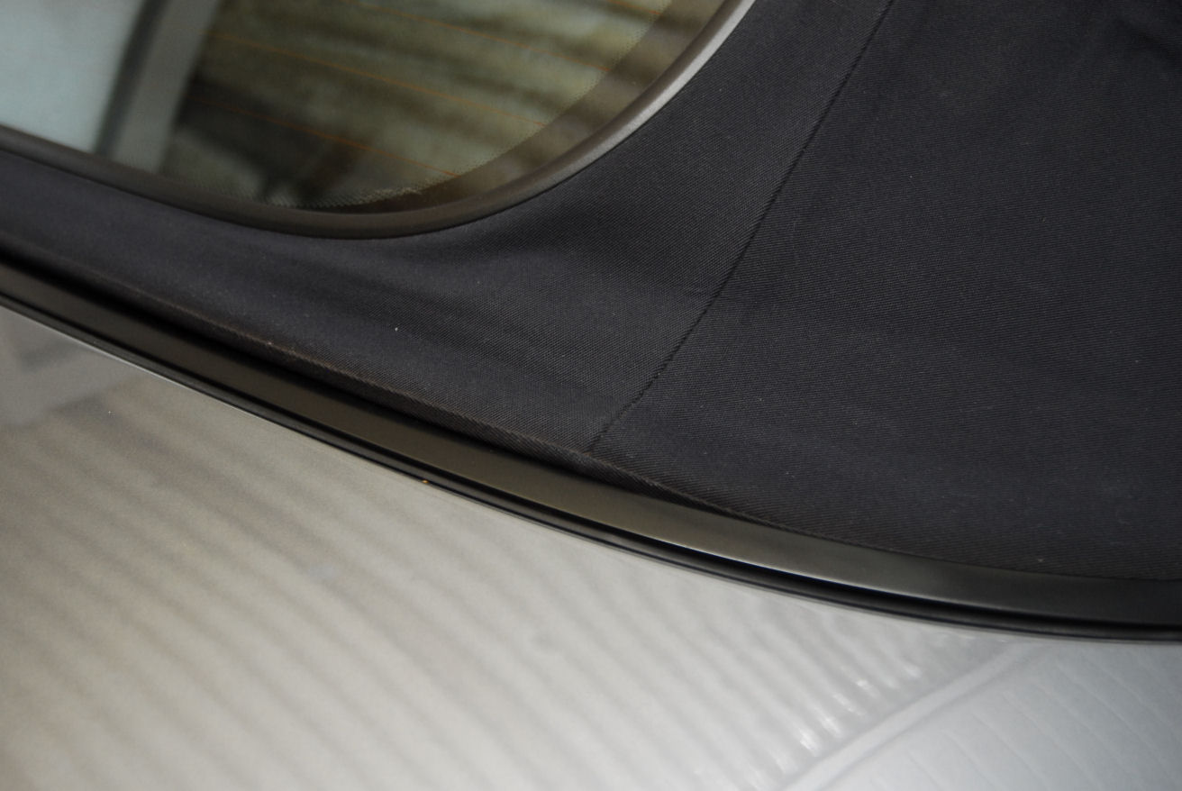

[FONT=arial"]Anyone able to say what's happening here?
[FONT=verdana,geneva"][FONT=arial"]
[FONT=verdana,geneva"][FONT=arial"]The beading around the edge of the hood is slowly but surely becoming exposed. At least I think it is! Only noticed it the other day but I'm sure it's only recently gone like this. Also, the contour of the hood when raised is not particularly smooth "" quite creased in fact adjacent to the rear window.
[FONT=verdana,geneva"][FONT=arial"]It raises and lowers fine but looks to me as though it's slipping out of the grip of whatever holds it in place around the edges and is loosing some of its tension.[FONT=verdana,geneva"]

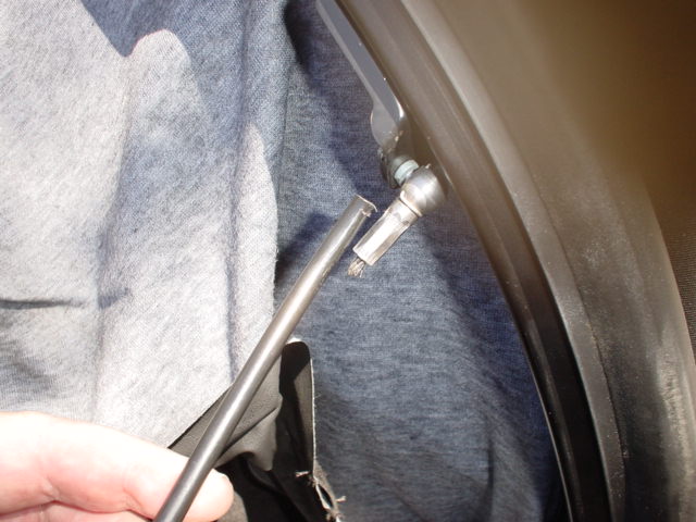

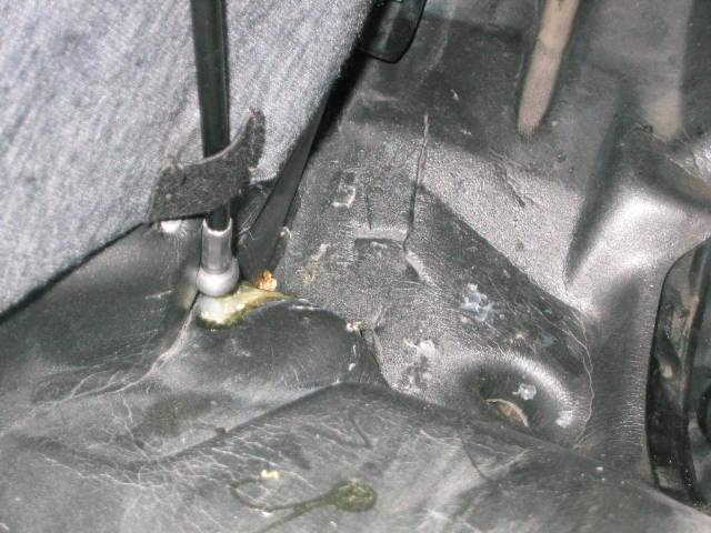

Not following. There is a tension cable on each side. About a foot long. There is a silver ball joint on each end of the cable. Pic is a broken tension cable.
There are 2 other black cables under there but they go from the top motor to the top transmissions. Those cables are very long and held in place to the motor with brass clips.
For the tension cables you pull hard on the silver ball joint and it comes out. Same for each end of the cable.

[FONT=arial"]Tool Pants, what I meant was that each of the cables seems to have broken in two!
I have detached the knuckle from its fixing on one of the broken pieces (its about 6" long) from what I think is the fixing point shown in your second picture.

Tool Pants, the number that you specified was for the fine tensioner wire that runs through the hood adjacent to the side windows (or so I'm told by Greg at PC East London). For referance, the heavy tensioner cables which you show in the pic carry the number: 986.561.191.02.
