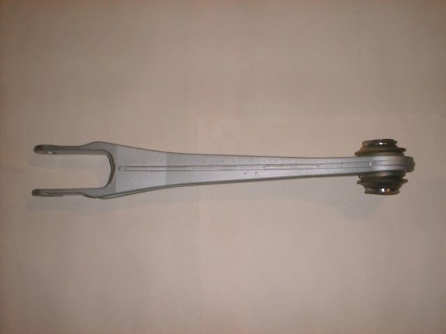

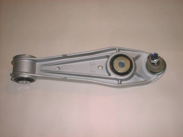

On the subject of replacement wishbones (or as they are referred to on Boxsters and 996's etc "" "track control arms"), we have recently had two exchange track control arms returned to us separately from different sources - for refurbishment - that we cannot repair because the alloy has both corroded and cracked through where the ball joint is fitted (and If someone will post me how to put photo's easily on this forum I will happily supply pictures).
On further inspection we found that there are no identifying casting marks (as always on Porsche OEM parts), the ball joint housing was 35mm diameter (whereas they have always been 33mm) and on testing the strength of the cast alloy we find it much weaker than the OEM parts we have here.
Having already been offered new replacements very cheaply from China (but that we would have to buy in bulk before receiving samples for testing "" so refused) and with rumours there are weaker options manufactured from the USA (or perhaps just sourced and sold from there) "" that don't last very long "" I suspect that these poor examples are the first of this supply and if so it is worrying and they could be very dangerous.
Proper tests and analysis are now under way but in the meantime if anyone can throw any light on the subject "" it could protect readers from making a serious mistake.

Edit by Richard: Pics added.

As I have had two 'control arms' replaced by independents recently I will inspect for casting markings.

To make the same parts plus the casting and sell for a similar price - something has to give and if it is the quality of the casting - it could - as the pictures reveal - be dangerous.
