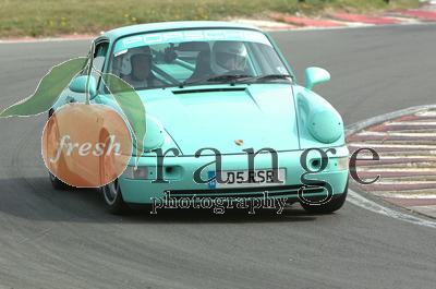

I remember your first comment..."How could a Cup Car driver endure this"......
Clubsport in the hot seat....is there some lift going on?
As you say Des, 20 mins stints make it interesting........As we recall, some racers fitted pas (leccy?) pumps on 64, it is no suprise that the evolution to 93 incuded fitment of pas, then that does run with more rubber.
Des, don't think that is the small lift piccy [;)]
