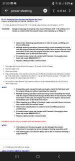

In case anyone needs it I've attached the 996 service manual page (see attached screenshot), which gives the instructions on how to top up and check the levels.
