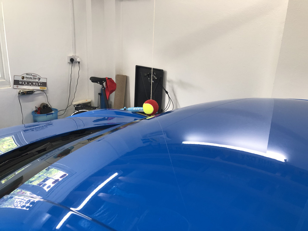

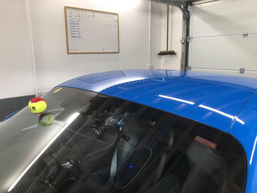

Mine has pdf on A pillars and front of roof, the latter extends about 6'' Make sure they cover from top of glass to roof as the strikes I've had seen to be just above the glass. Some fitters have A pillar and Front edge of roof in a one piece pattern and others such as Topaz use two pieces. If you polish with Autogylm or similar you'll get a white reside line just as you will on any other visible pdf join but with a clear type of sealant or polish it is not that obvious.

Thank you for your reply, I do not use a polish that leaves a residue and is absolutely clear so shouldn't be an issue. I'll check what method the installer will be using, I guess one piece preferred. If you have any photos I would be very interested in having a look. Regs Chris
Thanks very much for that. Can't really notice from the front view and only the slightest line from the rear view which is masked nicely by the reflections.
