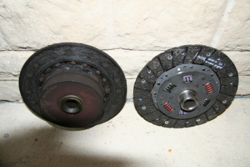

Thanks for the ideas Jon, in the end I had to cut a slot through the head with a Dremel and lever the bolt with a long screwdriver. I've now got the clutch out and can see why there was so much backlash through the transmission. As you can see in the picture, the rubber has completely broken up and transfers no torque. The clutch plate just bounces between the hard stops which must be about 60° apart. I think this is the original clutch plate as everything appears it's never been touched, still not bad for 16 years and 100500 miles.
